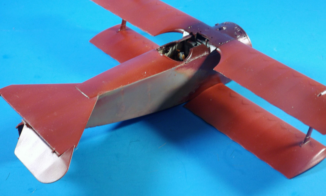

Here is a photo from My DR1 build. Had to strip one side. Managed to strip what I needed and save the rest. Stripped as stated above. It had a base of acrylic beige and was covered with Drooling Bulldog Lacquer red.
