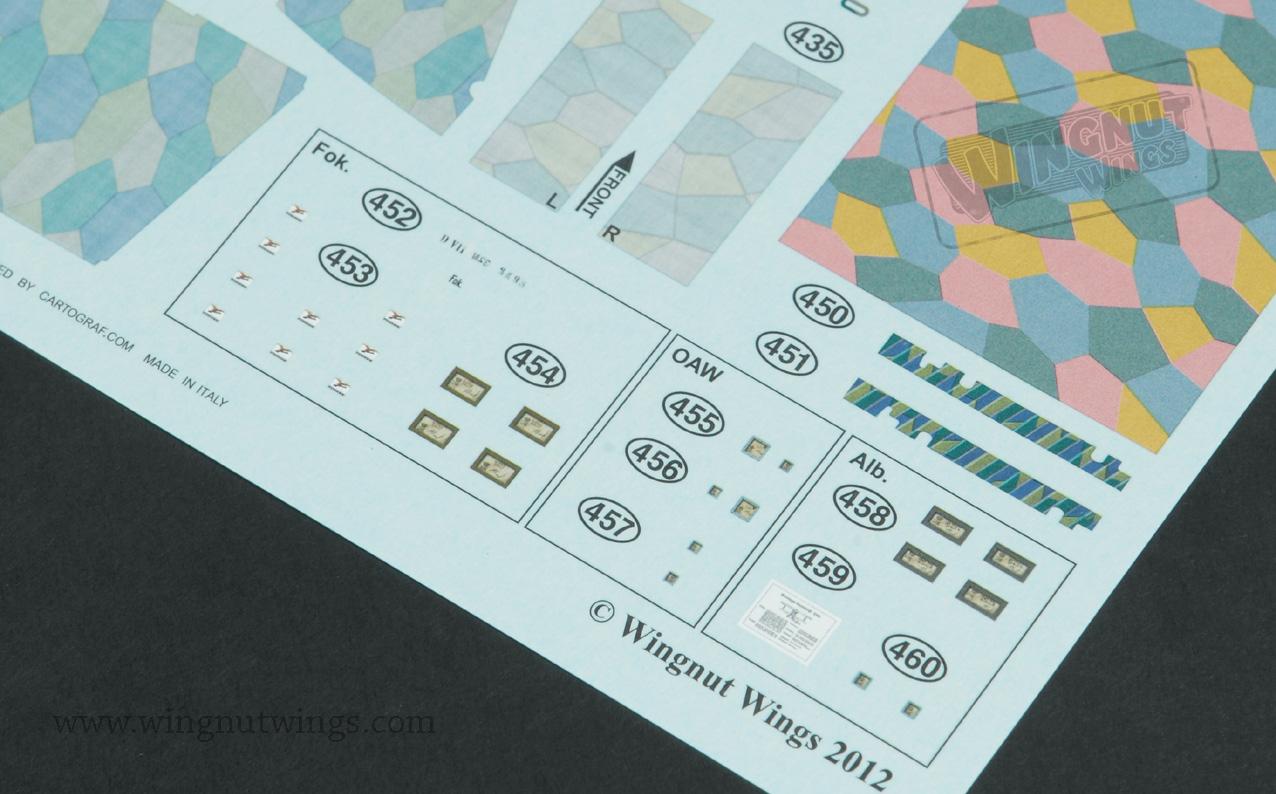

On the WNW website there is clearly visible, that the old decals are printed by cartograf.com in Italy (this is visible on one border in small letters). Those are simply the BEST decals available world wide, but don't seem to be cheap.
One example from the WNW web site:
You mention Eduard decals, the highest price range (limited editions and some Profipacks) are printed by Cartograf too, others (e.g. cheap Weekend editions) printed by Eduard themselves. The latest editions of those are very nice.
I never had any issue with a Cartograf decal (also from Revell kits).
So I guess the problematic sheets are NOT printed by Cartograf? Could you please check?
If this are also Cartograf ones, that they have really a production problem.
Hi Frank,
The Eduard kit was a Profipack Fokker D. VII and the decals were Cartograf. The WNW kit is the Sopwith Dolphin and the decals are also Cartograf and dated 2017. I think the later decals may be the culprit. I'll go ahead and contact WNW just to let them know in case it is a problem with the batch or something. The hairdryer does really help but the Eduard kit decals worked very well with just water and a bit of setting solution on tough spots.
