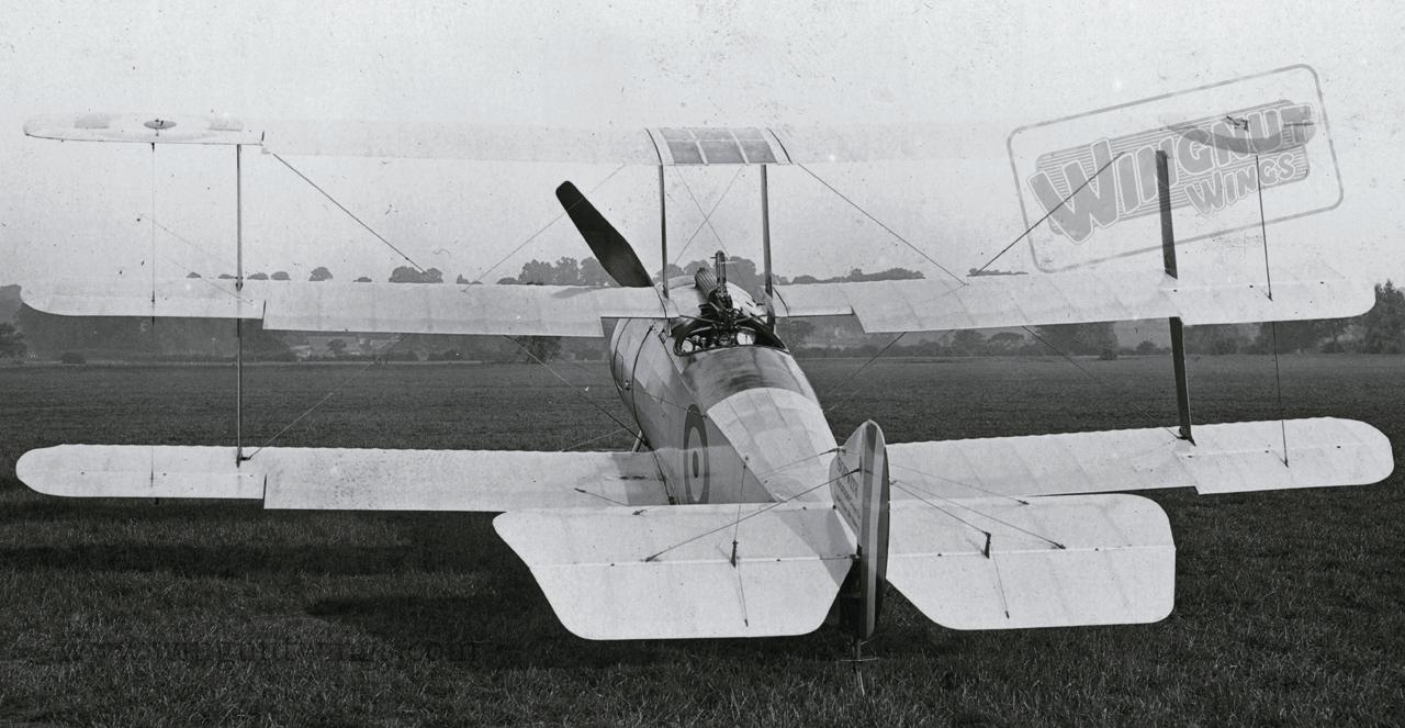

That's one of the lovely Gaspatch Vickers guns again. What is shown is my interpretation of what's in this picture on the WNW website:
The Vickers here would probably have the Sopwith Kauper gear, so I've cut the trigger motor off the top of the Gaspatch gun. The picture seems to show the top cover open, which doesn't help! There is no disintegrating reel chute on the left side, this 'plane would probably have used a belt instead going to a reel behind the dash, so that's what I have medlled. The back of the gun is a bit of a puzzle. It may be it had the Sopwith windscreen removed in this picture, I've chosen to show the four handle brackets with wooden handles installed like the ground gun. The handle brackets are what the Sopwith screen was attached to, probably without the wooden handles
