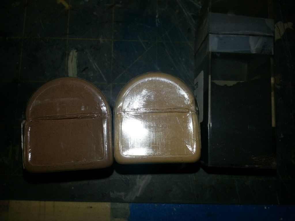

Ok. Part 2.
After I let everything sit overnight, I started this morning by gathering up my powders.
From left to right, Mig pigments Dark Earth, Mig Pigments Europe Dust, and Aim Weathering Products Black chalk powder.
First a layer of black chalk. I pretty much just put it everywhere. To include the bench, floor, my arms, etc...
Then the Mig Europe Dust to act as just that. Dust.
After that, the Mig Dark Earth. I try to stay in the rubble piles with that to give them a little more depth.
Don't be afraid to blend them together on the base. There should be a very slight, practically unnoticeable transition between the colors. Lastly, seal it all with another coat of Dullcoat. Now it's ready to be handled. Tomorrow I'll post a picture of the finished base, with a personal touch I added, as I like to title all my model dioramas.

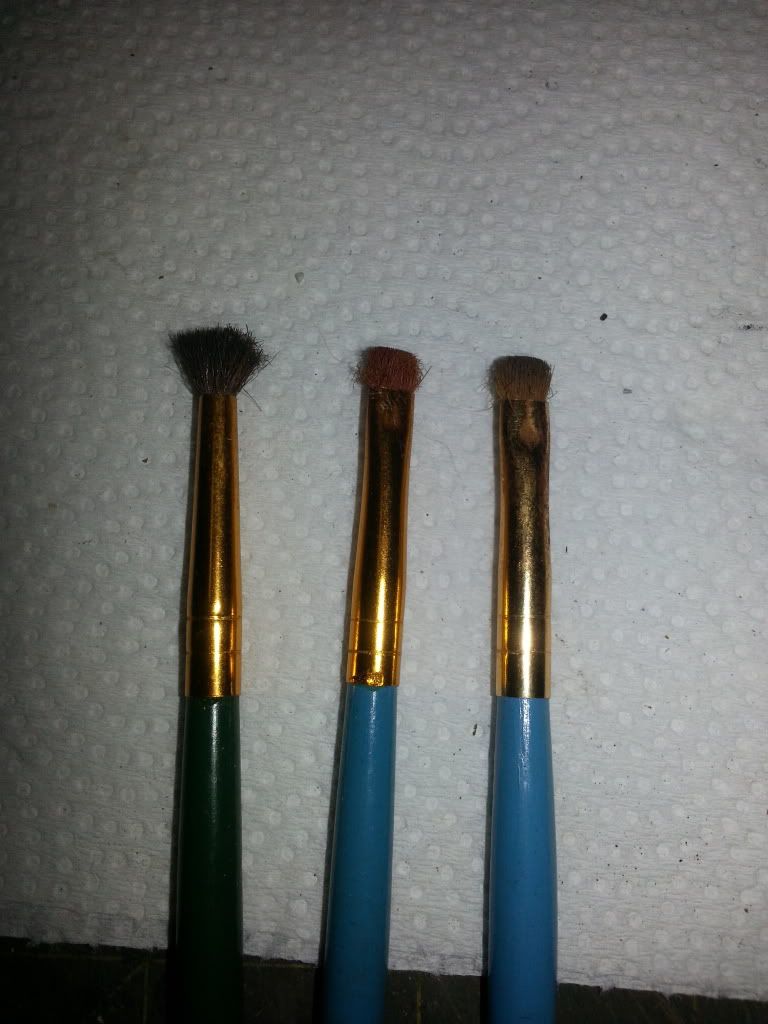

Thanks very much Joe for your indepth look at weathering the base, it certainlt turned out well and looks very realistic. Just one question, what type of brushes do you use to apply the pigments?

Thanks Des, as for the pigment and chalk brushes, I tend to use a stiff or semi stiff bristled brush, no more than a quarter inch wide, (forgive my non metric brain), that's been cut down to a small nub. The brush should have the same effect on your material as a shoe brush would on a shoe. Same resistance, if you will. I'll post pics of the brushes I used tomorrow.
Word of caution though, make sure you keep like with like. For example, never use a brush used for black on anything light colored. Trust me, it may LOOK clean enough, but it's not.  :-\ I have around 5 or 6 different brushes and mark them with different colored paint bands. Black band on the black brush, brown band on the brown brush, etc...
I've found the best brushes to be cheap, synthetic ones you might find in the arts and crafts aisle of your local chain store.
As for the washes, any soft brush that will allow the wash to flow smoothly without shedding bristles is fine.

So here is the finished base. Using a dental pick, I carved the name "O Fortuna". I like giving my dioramas and displays a name that relates to what you see. Since this will be a Roman Legionaire, Latin seemed appropriate.
I also thought I'd show what type of brushes I use to apply my pigments. Notice, they're cut pretty short.

Thanks very much for the tutorial Joe, I have picked up a few good pointers, and thanks for the picture of the brushes.
