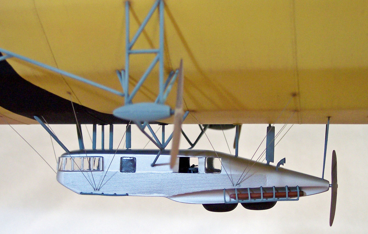

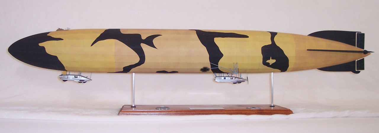

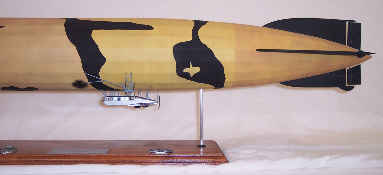

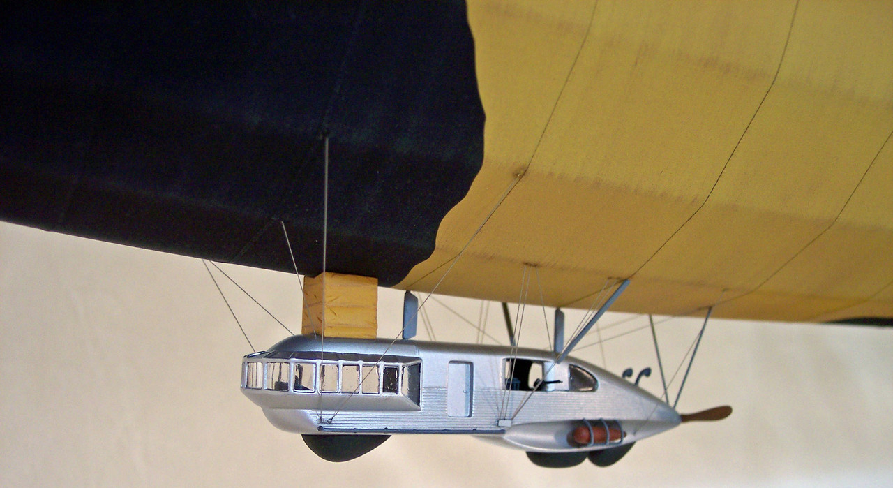

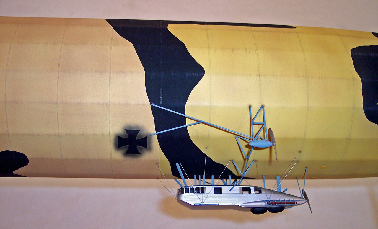

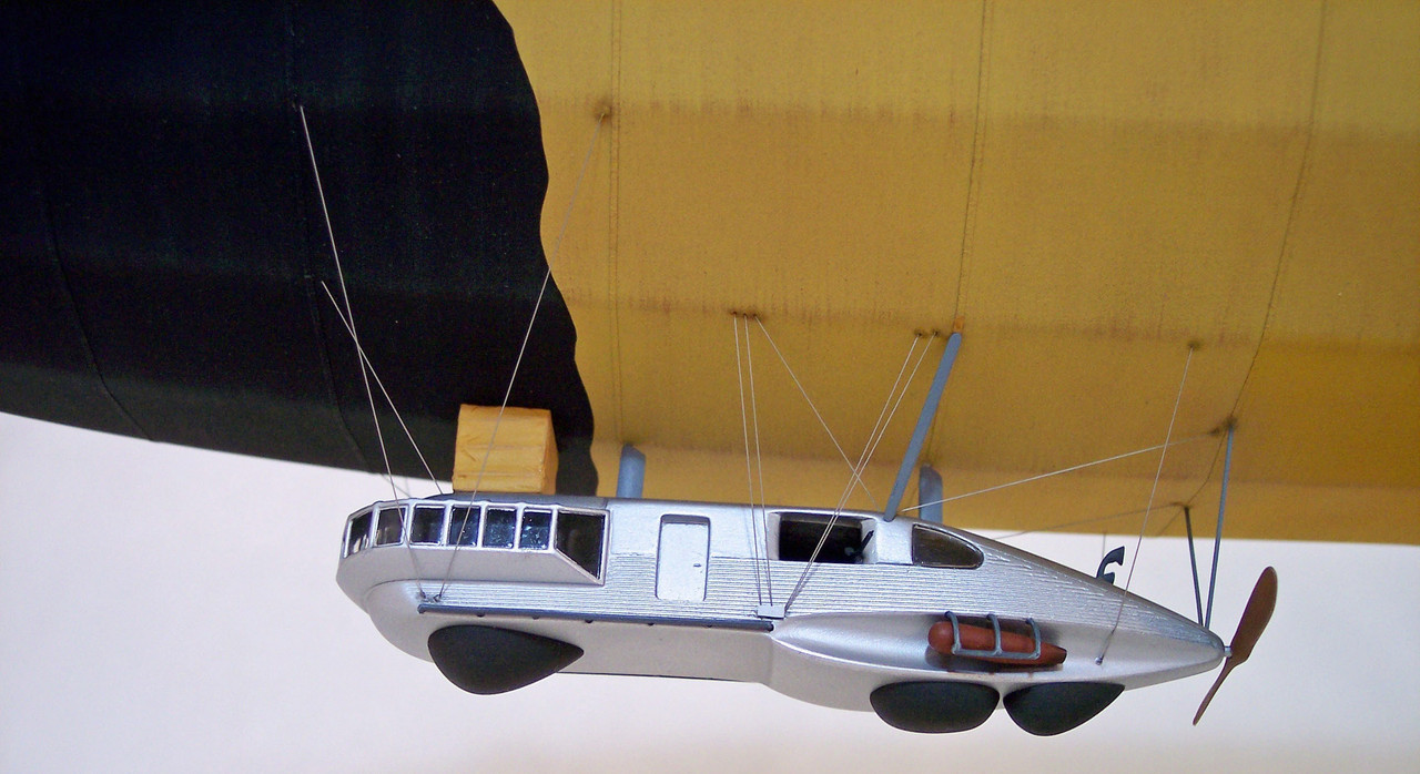

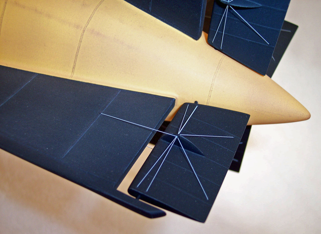

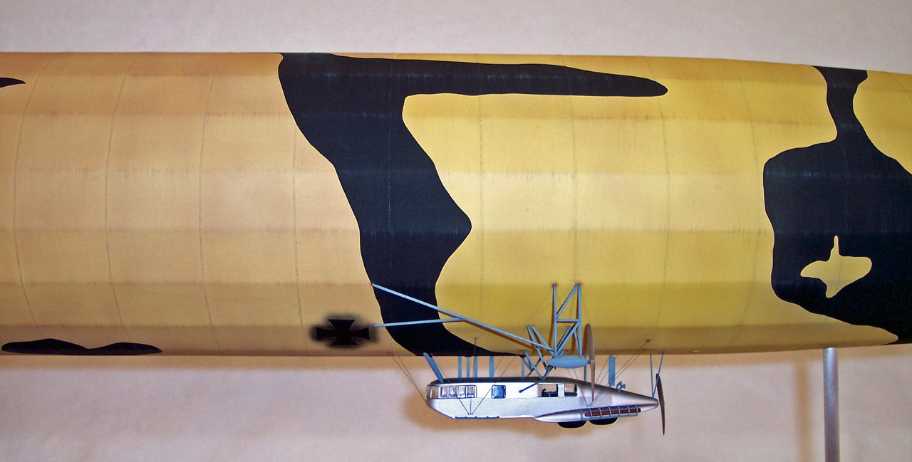

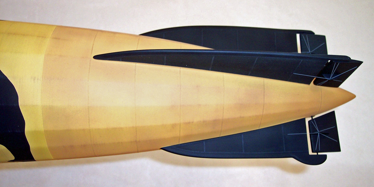

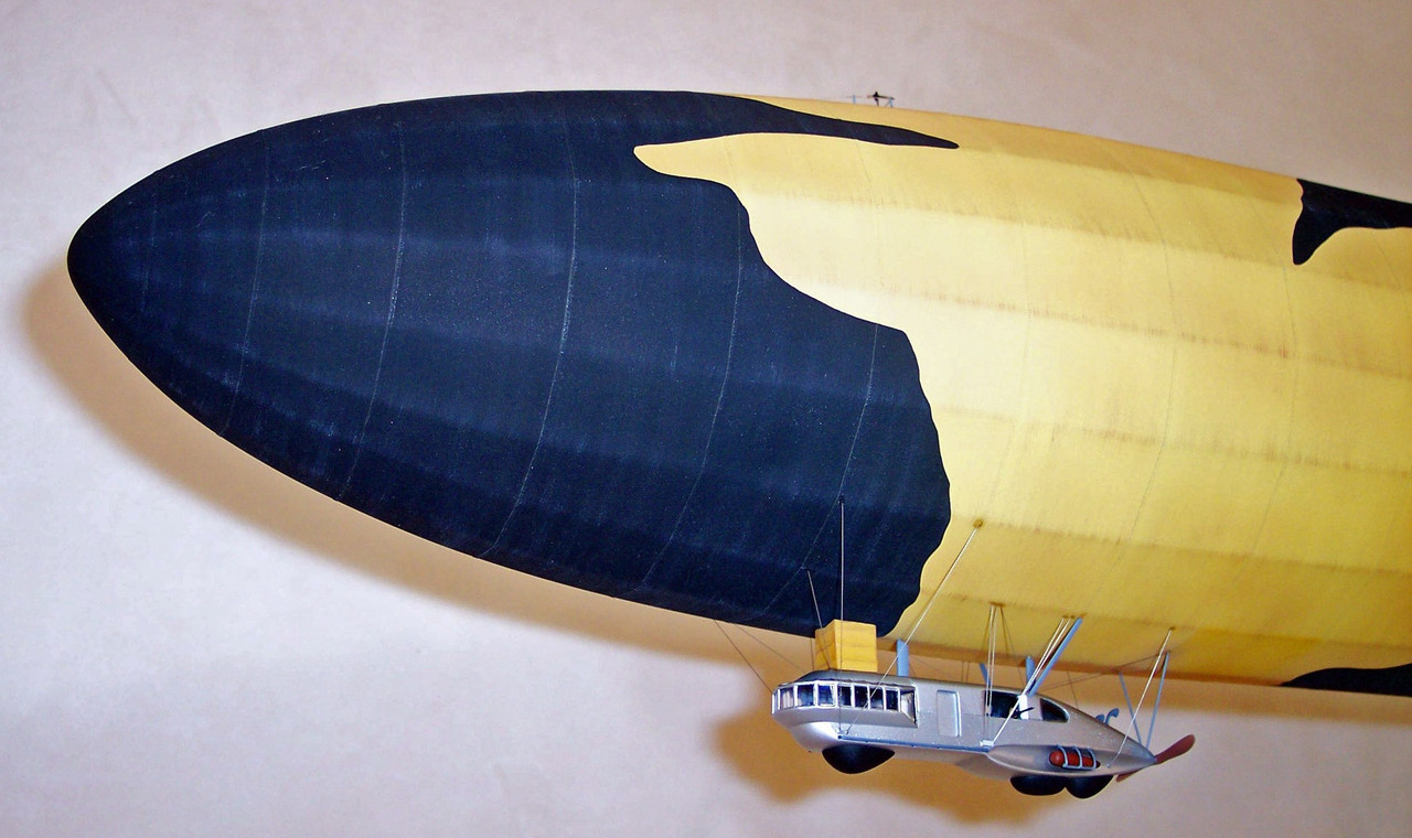

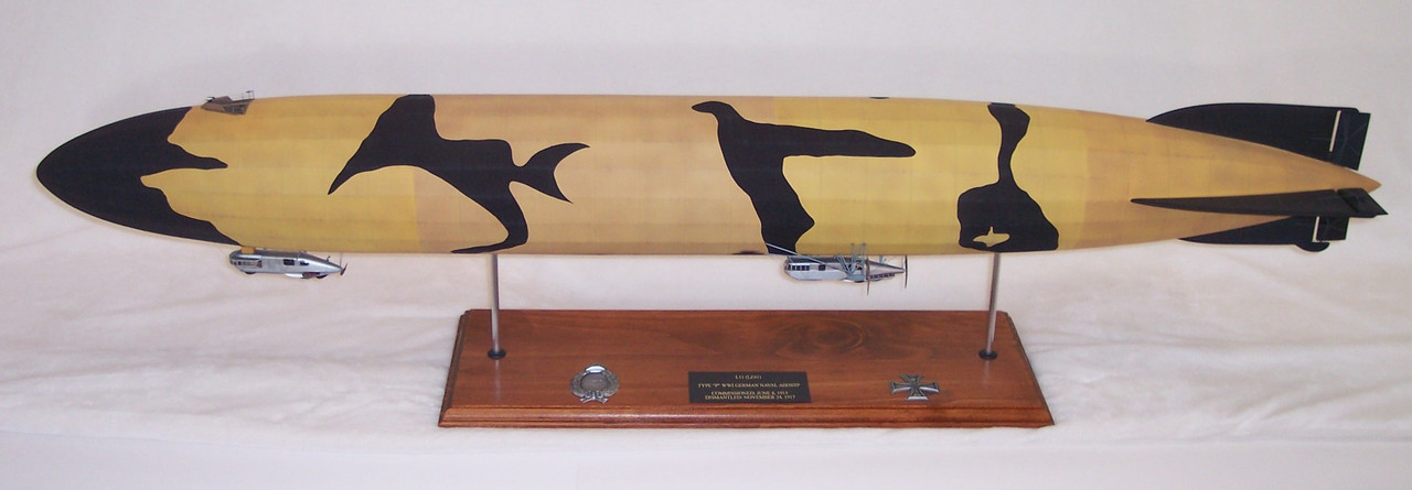

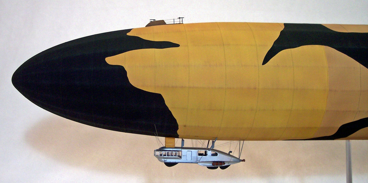

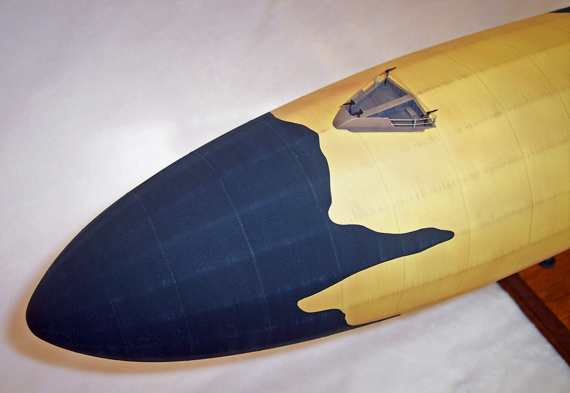

Fellow Modelers,

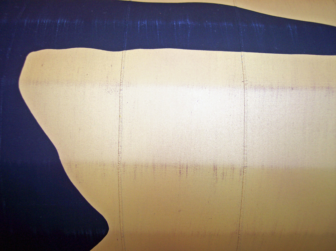

Below are photos of my Hippo Models 1/144 scale WWI German naval airship LZ41 (L11).  It is a huge model with an overall length of 44.5 inches.  The model contained 96 tan and clear resin parts with a majority of the pieces used on the two gondolas that hung under the hull.  There were no instructions or paint color references (i.e. FS numbers) provided.  I tried to make my model look exactly like what was on the model box top and on Hippo Models website.  Actual WWI German zeppelin colors are very elusive, and heavily debated from what I have read.  The two main colors used on the hull were black and a special mix of tan/dark yellow.  A dirty fabric effect was created by dry brushing tan over all the yellow areas, and dark ghost gray over all the black areas.  Very small surgical steel rods (.005 inch diameter) were used for the gondola guy wires.  The ship carries a unique test camouflage that was applied shortly after it was retired from combat.  Unfortunately this model is longer available from Hippo Models, which is too bad since it is a really good resin kit.  Listed below is a short history of L11.

Wow! That is a very impressive model. Nice finish too. Is it very heavy?
Where do you keep it - on display?

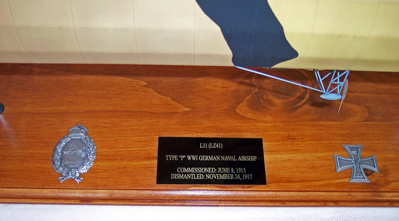

Jamo-The hull is hollow, but yes the model is heavy and hard to handle.  I have it in a large, glass display case (very similar to a jewelry/watch display case you see in department stores-sliding doors that open in the back).
LindseyT-I think I used two bottles of dark tan and one bottle of black painting the hull.

WONDERFUL model and finish! I particularly love the "weathering" over the ribs!

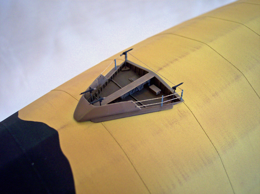

Guess I need to catch-up on my research . . . never realized there was a "crows nest" platform on top of the bag holding guns and gunners. I wonder who "volunteered" for those positions?  :o
