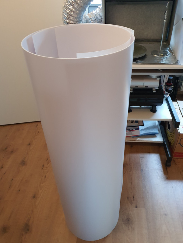

Would it work the other way around to straighten curved styrene? A while back I bought 4 sheets 0.5 x 140 x 100 mm styrene sheet. Or so I thought....
I was delivered in a big tube. Turned out to be 0.5 x 1400 x 1000 mm sheets. Paid only € 32.00 for it though.
I tried this, but it didnt work:
You could try placing the styrene between two minimum 5mm thick sheets of absolutely clean glass. Place in direct sunlight. Check every thirty to sixty minutes depending on the temperature.
I wouldn't need a 50 gallon asparagus pot; I'd cut of strips of the length I need.
