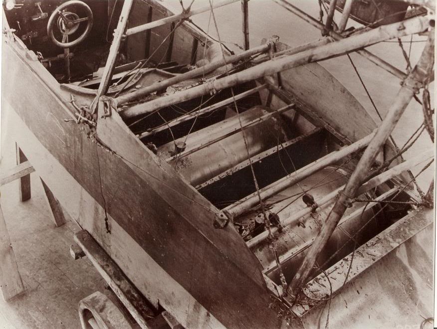

The fuselage halves internals were painted already, so all I did was add the forward wood grain (roughly depicting the diagonal strips seen in the CSM XVII) to the forward fuselage and interiour frames -which came pre-rigged and are only dry-fitted here awaiting further detail painting:
