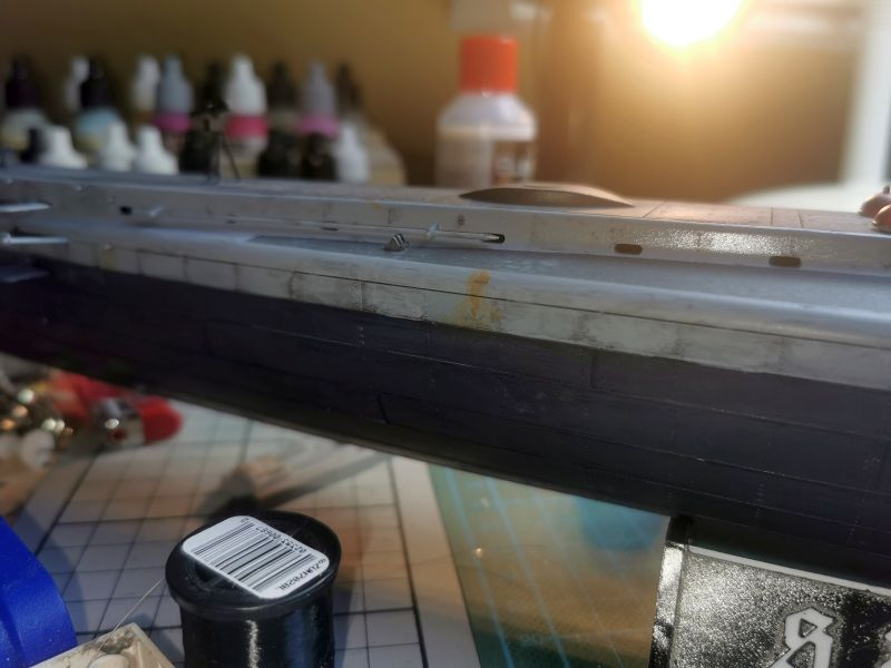

Since the colors used are all matt, the entire model has now been covered with a clear lacquer silk gloss in order to be able to start washing etc. For this purpose, the tower was now also glued to the deck, and the four red mountain buoys glued into the recesses provided for this purpose. This was followed by the application of the decals. These were also covered with decal varnish.
After the paint had dried well, I started with a black wash (I have to admit that the following work steps were a bit new territory for me, as I never tried to age my previous models so intensely). I mainly did the washing on the light gray areas, as they wouldn't have made much sense on the underside of the fuselage. A subtle chipping has now been carried out on the upper part of the hull and tower with rust from Revell, and then given a rust wash. The last point was a salt streaking (by AK) of the upper hull area and the deck.

Jürgen, thanks for sharing your construction and painting steps. The subtle weathering on the upper surfaces worked out superbly. Again - excellent work on your most interesting model!
