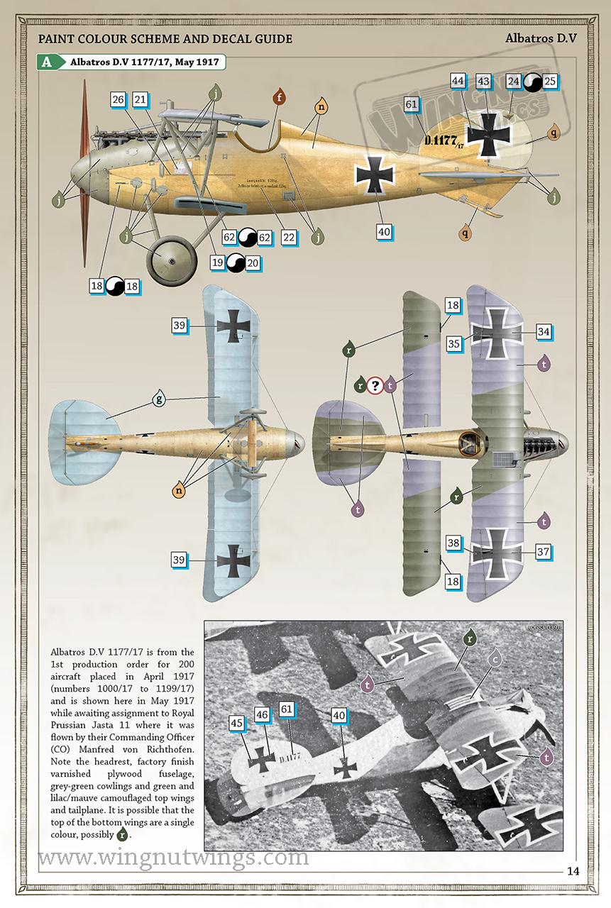

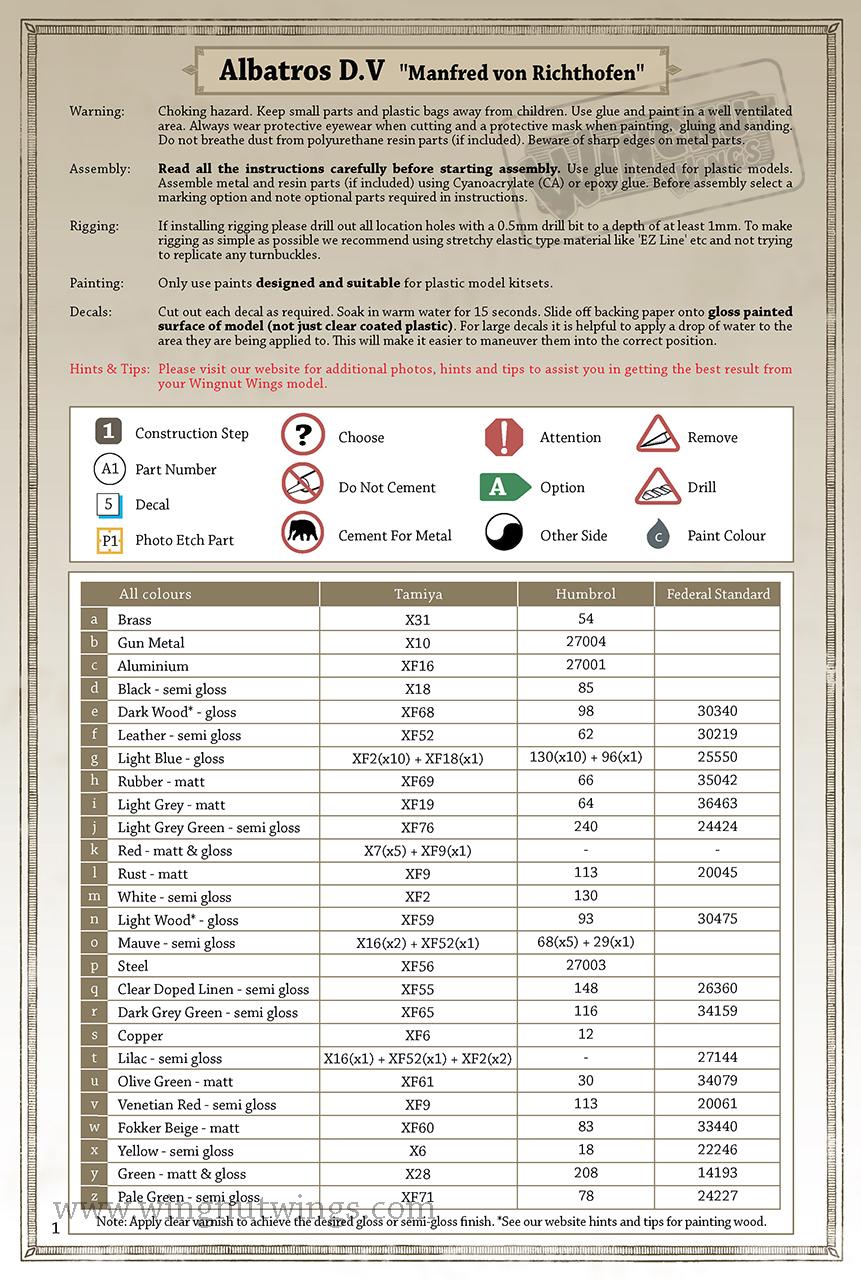

Hi!
I'm going to build a d.V from WnW Richtofen kit. The serial 1177/17 in is original colors, not overpainted red.
This one:
http://www.wingnutwings.com/ww/v507F2642/www/products/model_kitsets/32601/online_instructions/7132601%20Albatros%20D.V%20Manfred%20von%20Richthofen%20Page%2014.jpg
I have a problem with the green on the wings. Instructions in the Richtofen kit say dark grey green XF-65 Tamiya FS 34159
http://www.wingnutwings.com/ww/v507F2642/www/products/model_kitsets/32601/online_instructions/7132601%20Albatros%20D.V%20Manfred%20von%20Richthofen%20Page%2001.jpg
In the old WnW D.V boxings the color was medium grey green  tamiya XF71 FS34227    (misterkit GC04)
This is new to me...  The color in the profiles is always the same, very close to the Medium green....
There where different batches? New researches available? Something else?
Thanks
Andrew
